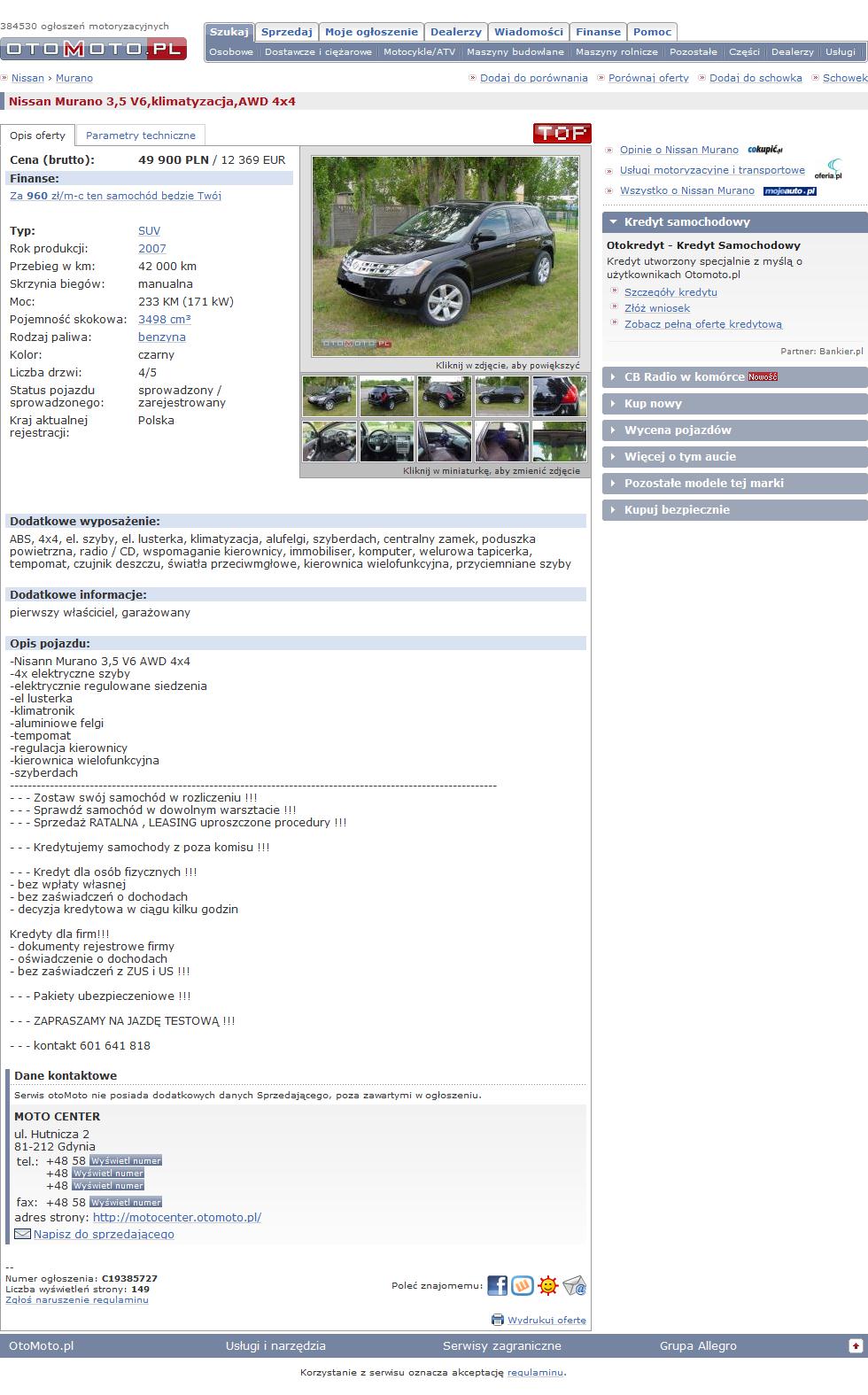

Proszę o sprawdzenie Nissana Murano 2007 VIN JN8AZ08W87W621551
Ogłoszenie:
otomoto.pl/nissan-murano-3-5-v6-klimatyz...d-4x4-C19385727.html
Dziękuję

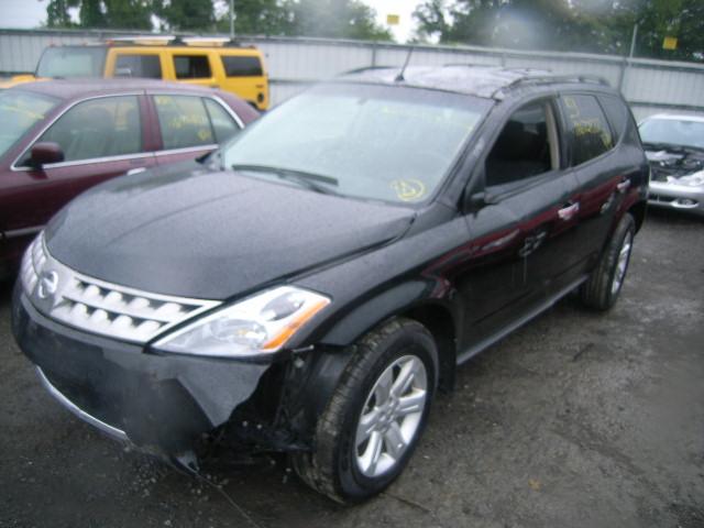

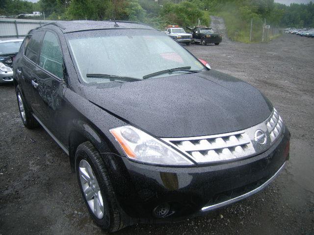

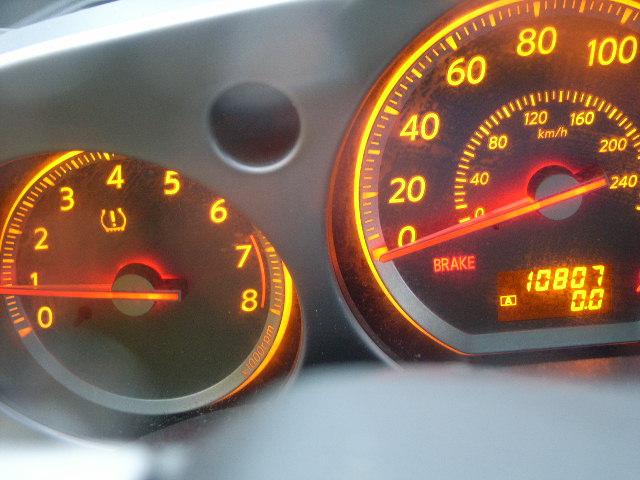

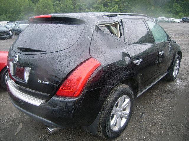

Odp: Prośba o sprawdzenie Nissan Murano 2007 VIN JN8AZ08W87W621551 2011/07/18 10:36 #14445
JN8AZ08W87W621551
VINJn8az08w87w621551
Year2007
MakeNissan
ModelMurano
Trim LevelSl/se
Body Type4 door wagon
Drive TypeFour wheel drive
Number of Cylinders6
Weight3855 lbs
Sequential Number621551
Actual Cash Value$31,600 USD
Repair Cost$0 USD
Title StateNEW YORK
Odometer10,807 ACTUAL
Primary DamageRollover
VINJN8AZ08W87W621551
Body Style4DR SPORT UTILITY
ColorBLACK
Engine3.5L 6
DriveAll wheel drive
Cylinders6
FuelGAS
KeysYES
Carfax Records InfoIMPORTANT! The CARFAX database contains 8 important vehicle history records on this 2007 NISSAN MURANO SE/SL/S that may confirm a clean history or uncover potential problems. Order the CARFAX Vehicle History Report to see all the information reported on this vehicle.
