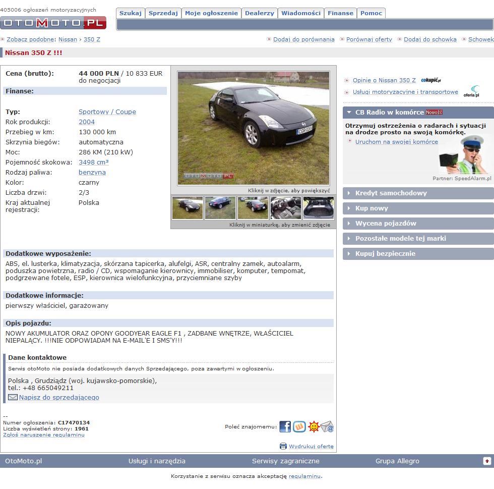

Witam poproszę o ocenę autka i jeśli to możliwe fotki z aukcji
autka o takim nr vin JN1AZ34E94M155374
autko jest wystawione tu : otomoto.pl/nissan-350-z-C17470134.html
pozdrawiam K. :)

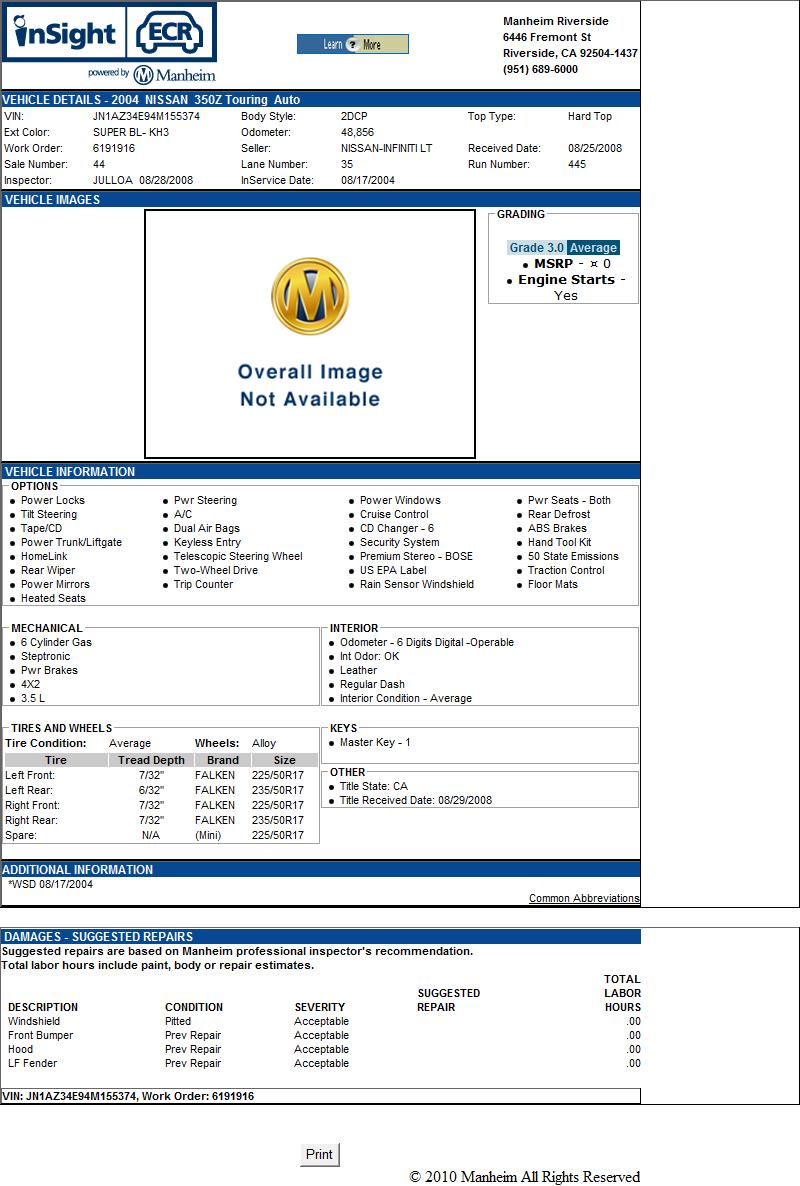

Odp: Nissan 350z 2011/03/15 18:38 #8970
JN1AZ34E94M155374
Model Year2004
MakeNissan
Model350Z
Body Type2 Door Coupe
Trim LevelBase; Touring; Enthusiast; Performance; Track
Engine TypeV6, 3.5L
CountryJAPAN
Assy. PlantTochigi
Production Seq. Number155374
Drive Line TypeRWD
Vehicle ClassSmall Car
Carfax Records InfoIMPORTANT! The CARFAX database contains 21 important vehicle history records on this 2004 NISSAN 350Z that may confirm a clean history or uncover potential problems. Order the CARFAX Vehicle History Report to see all the information reported on this vehicle.
