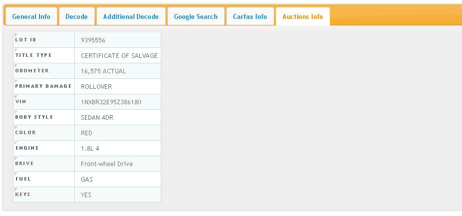

1NXBR32E95Z386180
Model Year2005
MakeToyota
ModelCorolla
Body Type4 Door Sedan
Trim LevelCE; S; LE
Engine TypeL4, 1.8L; EFI
CountryUNITED STATES
Assy. PlantFremont, CA
Production Seq. Number386180
Drive Line TypeFWD
Restraint SystemDual Air Bag; Manual Belts
SeriesZZE130L
Vehicle ClassSmall Car
Horsepower130HP
Engine Series Code1ZZ-FE
Repair Cost$0 USD
Title StatePENNSYLVANIA
Title TypeCERTIFICATE OF SALVAGE
Odometer16,575 ACTUAL
Primary DamageROLLOVER
VIN1NXBR32E95Z386180
Body StyleSEDAN 4DR
ColorRED
Engine1.8L 4
DriveFront-wheel Drive
Cylinders4
FuelGAS
KeysYES
Carfax Records InfoIMPORTANT! The CARFAX database contains 11 important vehicle history records on this 2005 TOYOTA COROLLA CE/LE/S that may confirm a clean history or uncover potential problems. Order the CARFAX Vehicle History Report to see all the information reported on this vehicle.

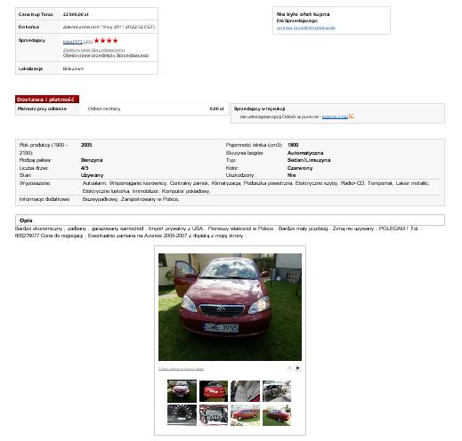

Odp: [UWAGA] 2005 TOYOTA COROLLA - 1NXBR32E95Z386180 2011/01/20 15:58 #6271
  • krzysieksel1969
  • krzysieksel1969 Avatar
po lekkim dachowaniu wspawa sie dach i po sprawie bedzie nastepny bezwypadek
