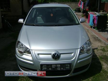

otomoto.pl/volkswagen-polo-1-4tdi-klima-C24978820.html Rocznik: 2006 VIN: WVWZZZ9NZ7Y081666 W lutym 2012 auto miało przejechane 337000km, a teraz ma na blacie 127000km.- cofka o 210.000km ![]() Do tego malowane dwa błotniki i maska z przodu (widać, że coś było) |

Zły VIN .. brak 1 znaku.
Brakowało W na początku .. chyba ![]() Dekodowanie numeru VIN WVWZZZ9NZ7Y081666 na www.automo.pl Nazwa dekodera: Dekoder VIN dla Grupy VAG #2 Vehicle Identification No.: WVWZZZ9NZ7Y081666 Model Designation: polo blue motion Date of production: 14.10.2006 Model year: 2007 Sales type: 9N30Z4 Engine code: BMS Transmission code: JDD Axle drive: 5S Interior trim code: 44 Roof color: 20 Exterior color/Paint Code: 90/P7X Activated carbon canister: [1E0] : Without activated charcoal canister Additional body covers, side: [6EU] : Additional body cover on wheel arch andside sill Additional child seat anchors: [3B0] : Without additional child seat anchor Additional dust seals: [6U0] : Without additional seals outside Additional tires (winter tires): [2WA] : Without additional tires Additional warning lights: [9TA] : Without additional warning lights Air bag: [4UF] : Driver's and front passenger air bagwith front passenger air bagdeactivation Air cleaner (engine): [1L0] : Standard air cleaner Antennas: [8L3] : Roof antenna Anti-theft protection system: [7AA] : Electronic vehicle immobilization device Antifreeze: [1C1] : Antifreeze up to -25 degree celsiustolerance up to -30 degree C Automatic transmission indicator light: [9FA] : Without automatic transmissionindicator light Backrest release: [3H9] : Backrest release for front seats with"Easy Entry" Batteries: [J0N] : Battery 330 A (61 Ah) Battery/alternator capacity: [NY0] : Standard battery/alternator capacity Body measures: [5C6] : Additional body measures Body style: [K8G] : Hatchback Body treatment: [6J1] : Special body treatment Brackets: [3P1] : Bracket for first aid kit and warningtriangle Brake pad wear indicator: [9U1] : Brake pad wear indicator Brake type, front: [1LR] : Front disc brakes with integratedadapter Brake type, rear: [1KD] : Disc brakes, rear Braking systems: [1AT] : Electronic stabilization program (ESP) Breakaway interior mirror: [4L2] : Dipping breakaway interior rear viewmirror Bumper: [2JE] : Partially painted bumpers CD ROM/DVD/SD card: [7QA] : Without CD/DVD for navigation CD changer/CD player: [7A0] : Without CD changer/CD player Carrier frequency for radio remote control: [5D0] : Without carrier frequency Cassette and CD storage unit: [4W0] : Without cassette and CD storage unit Center high-mounted stop light: [8R1] : Center high-mounted stop light Center rear seat belts: [3C7] : 3-point seat belt for center rear seat Chrome work package: [QJ0] : Without aluminum/chrome work package Climatic zones: [0Y1] : Standard climatic zones Component part sets with country-specific design requirements: [B0X] : Component parts set, complying withvehicle type for Germany, various parts Components with special surface appearance: [6FN] : Exterior mirror housings with specialsurface Cruise control: [8T0] : Without cruise control system (CCS) Cruise control warning and speed limit system: [6Y0] : Without cruise control warning system Cup holder: [4M0] : Without cup holder Customized installation: [FC0] : Without customized installation Dashboard: [4N0] : Standard dashboard Dashboard illumination: [7V2] : Dashboard illumination, not dimmable Delivery equipment: [2A0] : Without delivery equipment Door and lid locking system: [4F1] : Central locking system Door and side trim panels: [3LA] : Door and side trim panel in woven fabric Doors: [0A1] : 2 doors Drawers under front seats: [QN3] : Drawers under front seats Emission standard: [7GG] : Emission standard EU4 DPF Engine cover: [NM1] : Engine cover Engine specifications: [D4T] : 3-cyl. turbo diesel eng. 1.4 L/59 kW TDIpump-jet injection systemBase engine is T0U/TF4 Equipment levels: [A8C] : Comfort equipment Exhaust tailpipe: [0P0] : Rear exhaust tailpipe (standard) Exterior mirror setting: [6XD] : Exterior mirrors: electricallyadjustable/heated Exterior noise suppression measures: [2B0] : Without additional exterior noisesuppression Fire extinguisher: [6A0] : Without fire extinguisher First aid kit / warning triangle: [1T2] : Warning triangle Floor mats: [0TA] : Without floor mats Foot area lining: [QM1] : Foot area lining with cover Fresh air intake for passenger compartment (with particulate filter): [2V1] : Dust and pollen filter Front fog light/additional headlight: [8WA] : Without front fog light Front license plate carrier: [6W1] : License plate carrier front (large) Front stabilizer: [0AQ] : Front stabilizer Front underbody guard: [1SA] : Without additional front underbody guard Fuel filler cap/door, locking option: [2W0] : Fuel filler cap Fuel quantity for initial filling: [1Z0] : Initial standard fuel filling Fuel systems: [0F6] : Fuel system for turbo diesel engine withdirect injection (TDI) Fuel tank treatment: [2LB] : Fuel tank with special materialtreatment Gearshift boot/cover: [6R1] : Leatherette gearshift boot Gearshift knob/handle: [6Q1] : Plastic gearshift knob/handle General operating permit, alterations: [C18] : Operating permit, alteration Generators: [8GL] : Alternator 120 A Glove compartment: [4Z1] : Standard glove compartment Grab handles at roof frame: [5N2] : Folding grab handles at roof frame Hand brake lever handle: [6PA] : Plastic hand brake lever handle Headlight: [8BB] : Halogen headlightfor driving on the right Headlight activation: [8K0] : Without special headlightactivation Headlight washer system: [8X0] : Without headlight washer system Headlight-range adjustment: [8Q1] : Headlight-range adjustment Headrests: [3J7] : Articulated and height-adjustableheadrests for front seats Heat accumulator system/additional heater: [7E6] : Electric auxiliary air heater Heated rear window: [8P1] : Heated rear window Heated washer nozzles: [9T0] : Without heated washer nozzles Heating and air conditioning system: [9AP] : Climatic air-conditioning system(semi-automatic) Horns: [8Y4] : High-sounding horn Identification plates: [1EX] : Special identification plate for ECfor M1 passenger vehicle Ignition/starter switch locking system: [0RA] : Without ignition/starter switch lockingsystem Insert for the filling up of unleaded fuel/fuel type: [2G5] : Filler neck module 1 without insert Inserts: [5TC] : Without decorative inserts Installation differentiation for vehicle components: [0EJ] : Installation differentiation fortransmission MQ 250vehicle components Interior light in driver compartment: [9GA] : Interior light with door pillar switches Key for locking system: [8QC] : Key with light Left exterior mirror: [5SL] : Left exterior mirror: aspherical Left vanity mirror: [4SC] : Left vanity mirror with cover Lock operation for tailgate/trunk lid: [4E5] : Tailgate/trunk lid unlockingfrom outside Lockable wheel bolts: [1PC] : Wheel bolts with anti-theft protection(unlockable) Luggage compartment cover: [3U1] : Foldable trunk cover Luggage compartment floor covering: [6SC] : Tufted trunk floor covering Luggage compartment lighting: [9E0] : Without trunk lighting Luggage compartment lining: [5A6] : Full fleece trunk lining Luggage net/pocket on backrest(s): [4U0] : Without luggage nets/pocketson backrests Manufacturing sequence differentiation: [0FB] : Pamplona manufacturing sequence Mass damper for steering wheels: [1Q0] : Without mass damper for steering wheel Molding roof liner: [6NA] : Unsplit molding roof liner Multi-function display/trip computer: [9Q1] : Multi-function display/on-board computer Nameplate set: [0NB] : Nameplate set in base trim Navigation device: [7Q0] : Without navigation device Outer rear seat belts: [3ZB] : 3-point seat belts, outer rear with ECElabel Owner's manuals: [0VC] : Information kit in German Paint preservative/transit coating: [5K1] : Paint preservative (wax) Park distance control: [7X0] : Without park distance control Partition: [3CA] : Without partition Pillar lining: [4XC] : Exterior pillar lining Platform group class: [7PA] : Platform group class 1 Platform module floor pan, rear: [4P2] : Rear floor panel module, type 3 Protective side molding: [4B2] : Body-colored protective side molding Radiator grille: [6KL] : Radiator grille Radios: [8UA] : Radio with CD player Rear axle: [0N2] : Heavy-duty rear axle Rear fog light: [8TC] : Rear fog light for driving on the right Rear headrests: [3Q6] : Three rear headrests Rear license plate carrier: [6P1] : License plate carrier rear (ECE) Rear seat catch: [6QA] : Rear seat catch Rear seats: [3NB] : Rear seat bench/backrest, completelyfolding Rear spoiler: [5J1] : Rear spoiler Rear window wiper and washer system: [8M1] : Rear window wiper and washer systemwith intermittent control Restraint systems, front: [4QV] : 3-point seat belts with electrictensioner and height adjustment, front Right exterior mirror: [5RQ] : Right exterior mirror: convex Right vanity mirror: [4TC] : Right vanity mirror with cover Roof insert/convertible top: [3FA] : Without roof insert (standard roof) Roof rails/roof load rack: [3S0] : Without roof rails/roof load rack Scuff plates: [7M5] : Without protective film for scuff plate Seat adjustment: [3L3] : Manual height adjustment for front seats Seat belt check: [9P0] : Without seat belt reminder Seat covering: [N2Z] : Seat covering for special editions Seat heater: [4A0] : Without seat heater Service interval prolongation: [QG1] : Service interval prolongation Shock absorption, chassis, front: [G31] : Front shock absorption Side air bag: [4X1] : Side air bag front Side and rear windows: [4KF] : Side windows in heat-insulating glass,from B-pillar and rear window darktinted Side lights: [7R3] : Side turn signal lights (white) Smoking/non-smoking package: [9JA] : Non-smoking package Socket: [7B0] : Without socket Spare wheel/breakdown set: [3F5] : Breakdown set Speaker installation: [8RE] : 4 speakers (passive) Special editions: [E0S] : "Blue motion" Special labels/plates: [0SB] : Labels/plates in German Speedometer cable and seal: [8CC] : Speedometer sensor without seal(electronic speedometer sensor) Steering: [1N2] : Power steeringelectro-hydraulic Steering column systems: [2C5] : Axial and vertical adjustable steeringcolumn Steering system arrangement: [L0L] : Left-hand drive vehicle Steering wheels: [2PQ] : Steering wheel for air bag system Sticker (customized or special edition): [0KZ] : Stickers for special editions Taillight assemblies: [8SG] : Standard taillight assemblies (type 2) Telephone/telematics: [9W0] : W/o car phone preparation/installation Tire pressure warning light: [7K0] : Without tire pressure warning light Tires: [H8P] : Tires 165/70 R14 81T Tool kit and jack: [1S2] : Tool kit Trailer hitch: [1D0] : Without trailer hitch Transmission specifications: [G0C] : 5-speed manual transmission Transmission types/gearshift mechanisms: [0G4] : Cable gearshift Tray areas package: [QE1] : Tray areas package 1 Trunk sill protection: [2P1] : Plastic trunk sill protection Type approval countries/countries with special requirements: [B01] : Type approval Germany Upgrading measures: [GP1] : Vehicles with special upgrade measures Vehicle class differentiation units/platform components: [0CL] : Vehicle class differentiation 6Q0-for build status Europe Vehicle specifications: [F0A] : No special purpose vehicle, standardequipment Vehicle type: [AZ0] : Vehicle with standard production scope Washer fluid level indicator: [8W0] : Without washer fluid level indicator Weight category front axle: [L10] : Suspension range 10installation control only, norequirement forecast Weight category rear axle: [0YA] : Weight range 1installation control only, norequirement forecast Wheel covers: [1NL] : Covers for alloy wheels Wheel housing liners: [KG2] : Wheel housing liner front and rear Wheels: [CK3] : Alloy wheels 5J x 14 Window regulator: [4R1] : Power windows Windshield glass type: [4GF] : Windshield in heat-insulating glass Windshield wiper arms/blades: [9PE] : Windshield wiper arms/bladeswith spoiler wiper blade Windshield wiper intermittent control: [8N4] : Windshield wiper intermittent controlwith potentiometer (four speeds) Child seats: [QA0] : Without child seat Front seats: [Q1A] : Standard front seats Air duct, front area: [VK1] : Air duct, type 1 Base engine: [TF4] : 3-cylinder diesel engine 1.4 LUnit 045.F Instrument inserts: [U0C] : Instrument insert with tachometerclock and km/h speedometer Pedal cluster: [VF0] : Standard pedal cluster Shock absorption, chassis, rear: [UA1] : Rear shock absorption Tire suppliers: [V0H] : DUNLOP tires Dekodowanie pochodzi z www.automo.pl |
