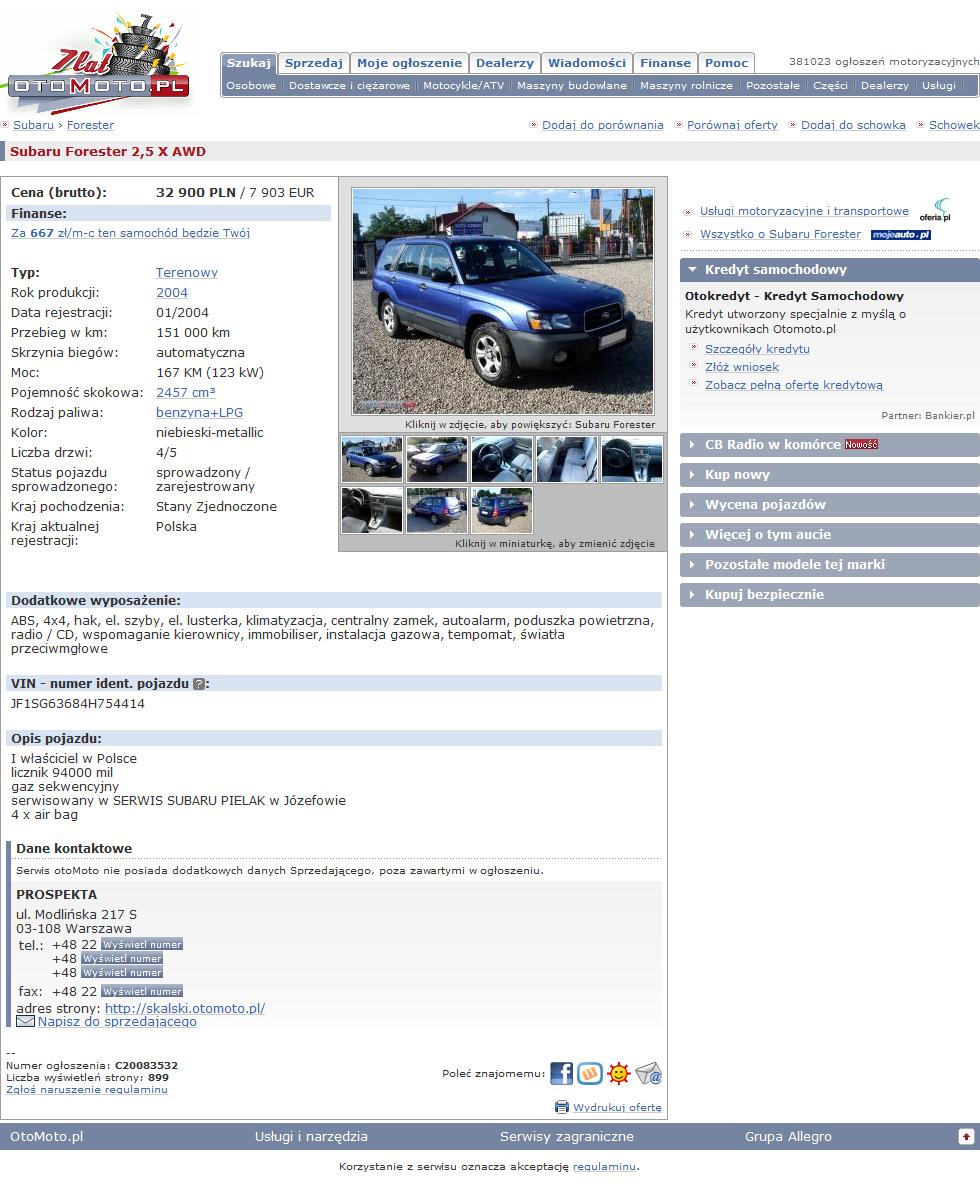

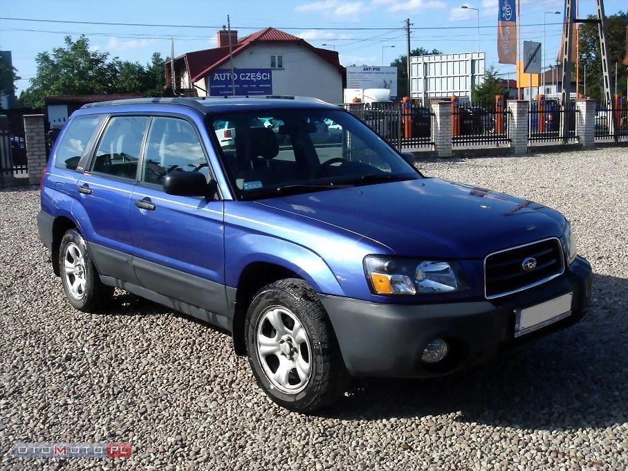

Witam
proszę o sprawdzenie auta przed oględzinami.
otomoto.pl/subaru-forester-2-5-x-awd-C20083532.html
VIN JF1SG63684H754414
Dziękuję i pozdrawiam,
Paweł

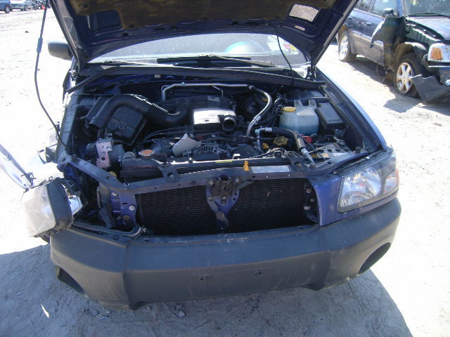

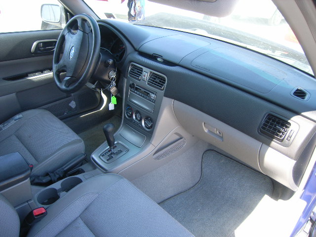

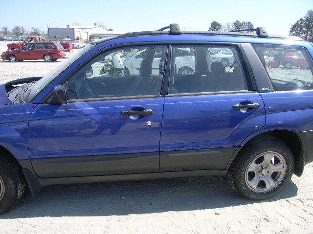

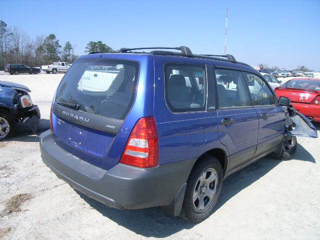

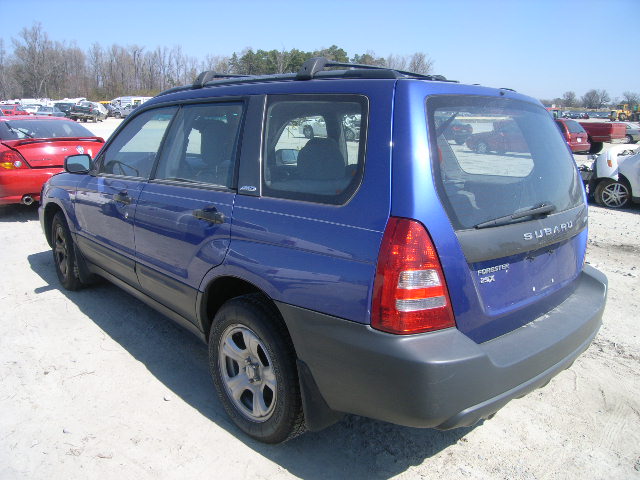

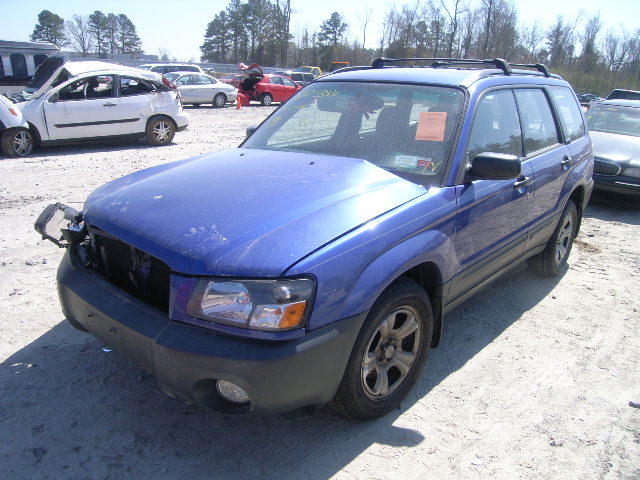

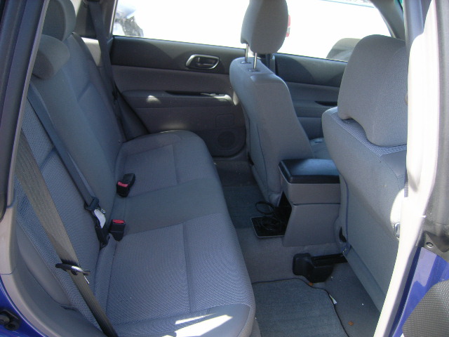

Odp: Subaru Forester 2,5 X AWD 2011/08/27 20:03 #15873
JF1SG63684H754414
Model Year2004
MakeSubaru
ModelForester
Body Type4 Door Wagon
Trim Level2.5X
Engine TypeB4, 2.5L
CountryJAPAN
Assy. PlantGunma
Production Seq. Number754414
Drive Line TypeAWD
Restraint SystemDual Air Bag; Manual Belts; Side Air Bag
Vehicle ClassSmall MPV
Transmission4 Speed Automatic
Actual Cash Value$13,550 USD
Repair Cost$13,574 USD
Title StateNORTH CAROLINA
Title TypeSALVAGE CERTIFICATE OF TITLE

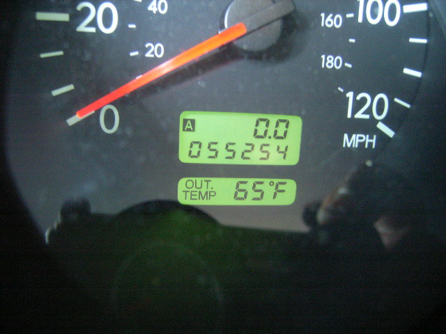

Odometer55,254 ACTUAL
Primary DamageFront end
VINJF1SG63684H754414
Body Style4DR SPORT UTILITY
ColorBLUE
Engine2.5L 4
DriveAll wheel drive
Cylinders4
FuelGAS
KeysYES
ConditionVehicle Starts
Carfax Records InfoIMPORTANT! The CARFAX database contains 9 important vehicle history records on this 2004 SUBARU FORESTER 2.5X that may confirm a clean history or uncover potential problems. Order the CARFAX Vehicle History Report to see all the information reported on this vehicle.
