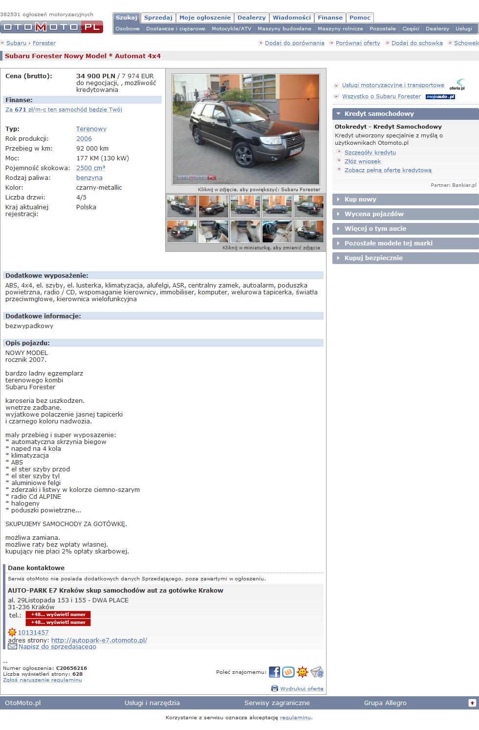

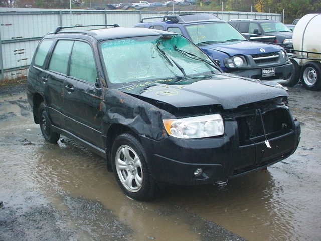

Proszę o sprawdzenie Forka 2.5 USA.
Auto stoi w komisie w Krakowie, sprzedawca twierdzi ze jest bezwypadkowy.
VIN: jf1sg63636h722411
link: otomoto.pl/subaru-forester-nowy-model-au...t-4x4-C20656216.html
Pozdrawiam

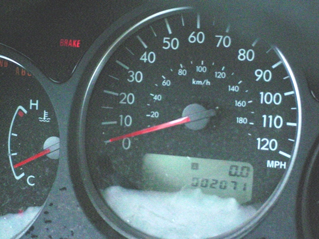

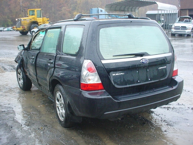

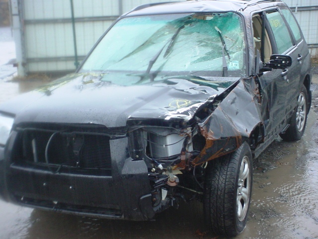

Odp: Subaru Forester 2.5 2006, VIN: jf1sg63636h722411 2011/10/06 18:58 #17053

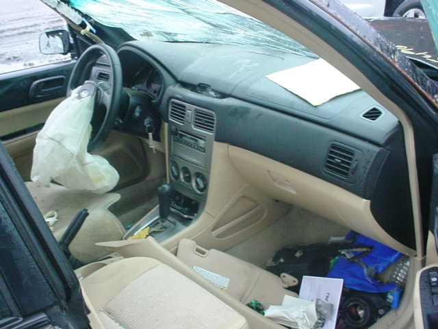

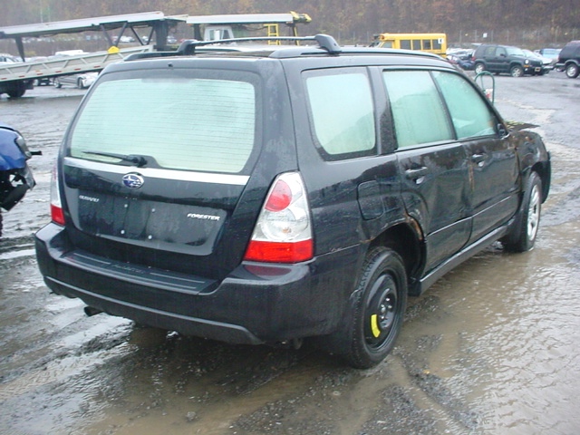

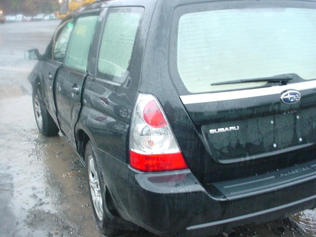

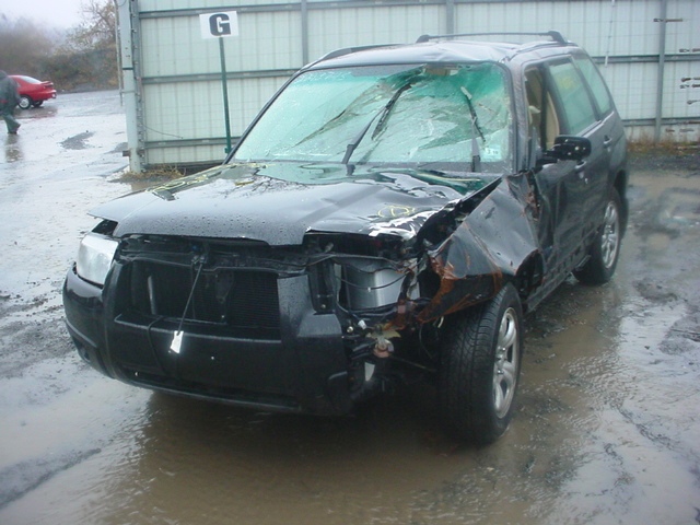

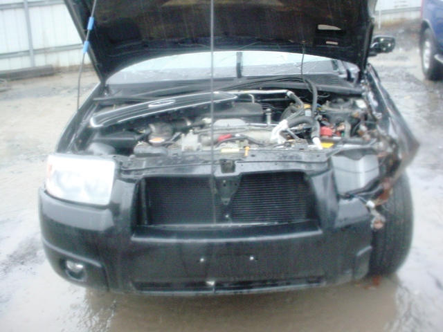

JF1SG63636H722411 Sprawdź ten VIN na autobaza.pl ▸
Model Year2006
MakeSubaru
ModelForester
Body Type4 Door Wagon
Trim Level2.5X
Engine TypeB4, 2.5L
CountryJAPAN
Assy. PlantGunma
Production Seq. Number722411
Drive Line TypeAWD
Restraint SystemDual Air Bag; Manual Belts; Side Air Bag
Vehicle ClassSmall MPV
Transmission4 Speed Automatic
Repair Cost$0 USD
Title StatePENNSYLVANIA
Title TypeCERTIFICATE OF SALVAGE
Odometer2,071 ACTUAL
Primary DamageAll over
VINJF1SG63636H722411
Body Style4DR SPORT UTILITY
ColorBLACK
Engine2.5L 4
DriveAll wheel drive
Cylinders4
FuelGAS
KeysYES
Carfax Records InfoIMPORTANT! The CARFAX database contains 13 important vehicle history records on this 2006 SUBARU FORESTER 2.5X that may confirm a clean history or uncover potential problems. Order the CARFAX Vehicle History Report to see all the information reported on this vehicle.
