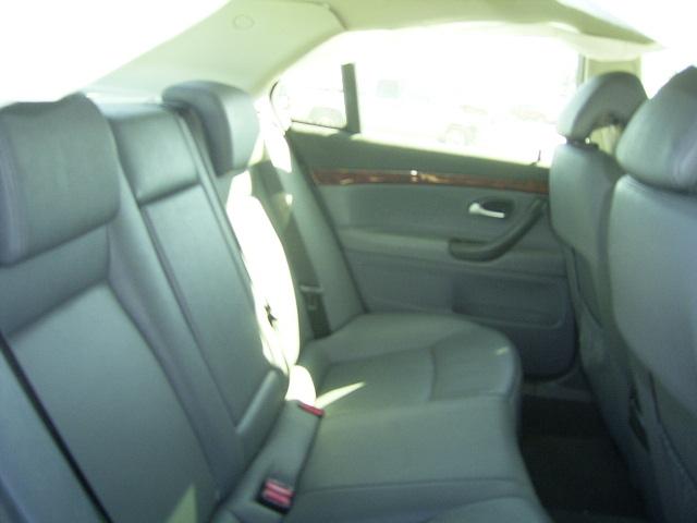

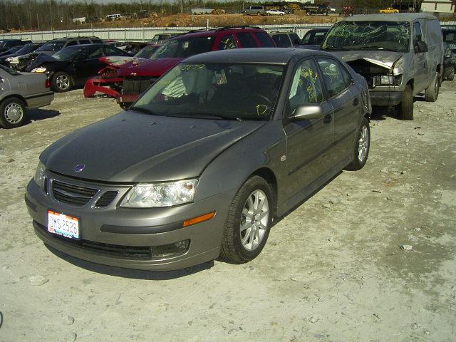

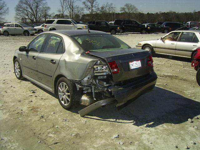

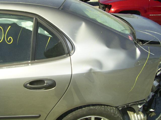

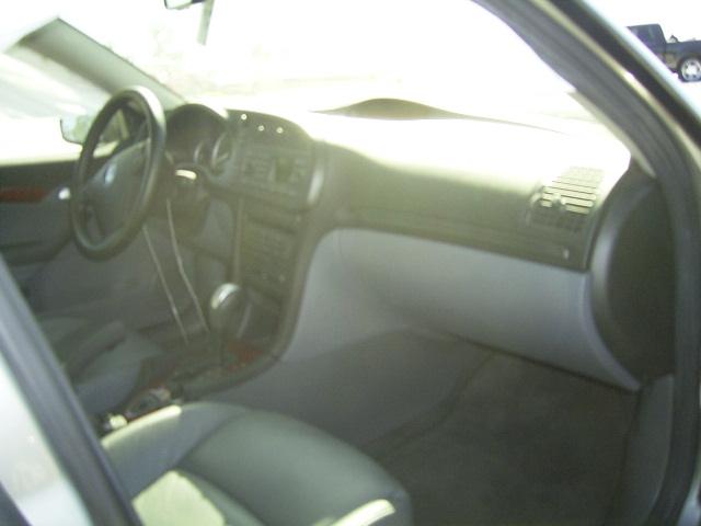

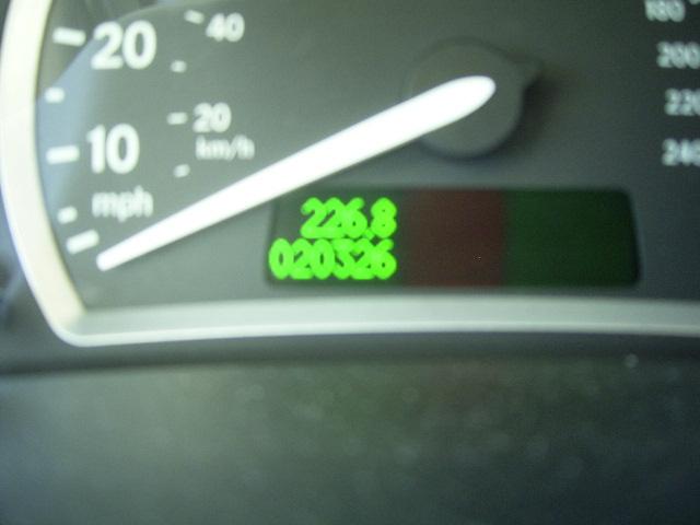

YS3FD49Y451060694
Model Year2005
MakeSaab
Model9-3
Body Type4 Door Sedan
Trim LevelArc
Engine TypeL4, 2.0L; Turbo
CountrySWEDEN
Assy. PlantTrollhatten
Production Seq. Number060694
Drive Line TypeFWD
Vehicle ClassMid-size Car
Actual Cash Value$22,763 USD
Repair Cost$28,100 USD
Title StateGEORGIA
Title TypeSALVAGE TITLE
Odometer20,326 ACTUAL
Primary DamageAll over
VINYS3FD49Y451060694
Body StyleSEDAN 4DR
ColorSILVER
Engine2.0L 4
DriveFront-wheel Drive
Cylinders4
FuelGAS
KeysYES
