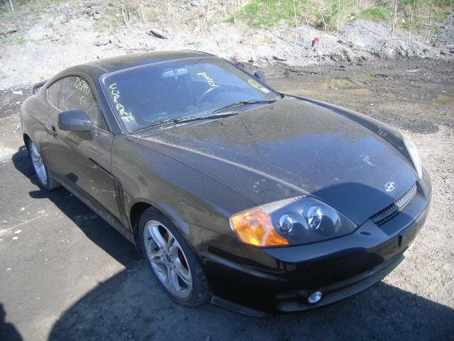

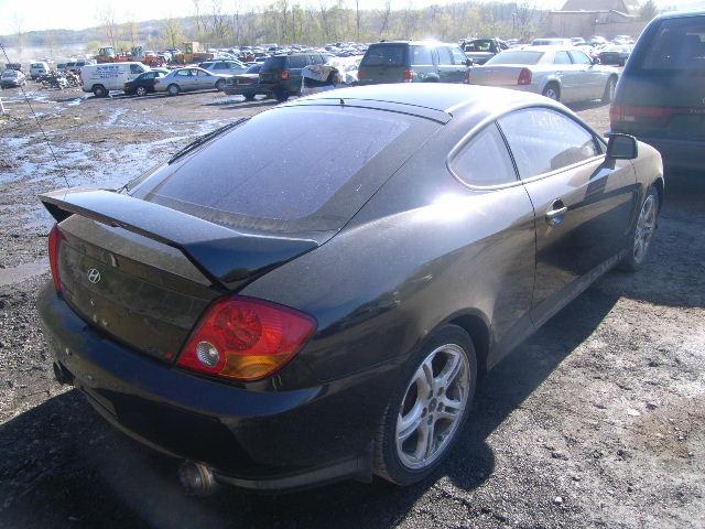

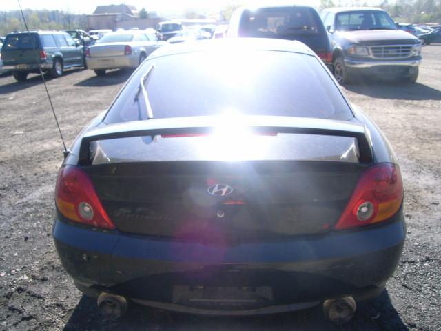

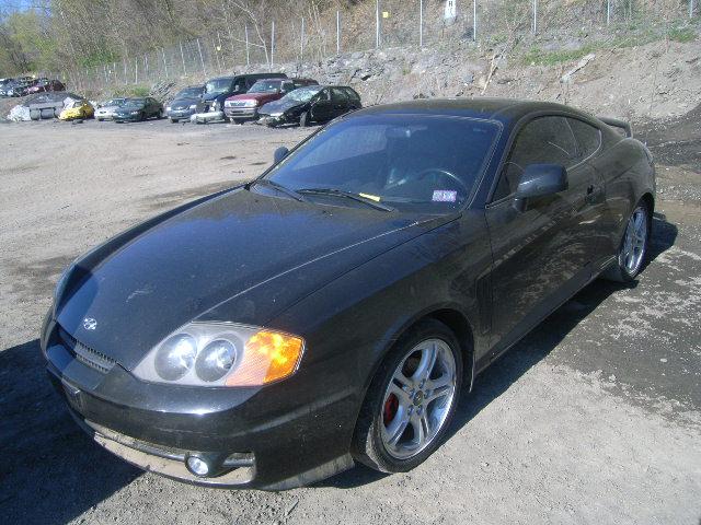

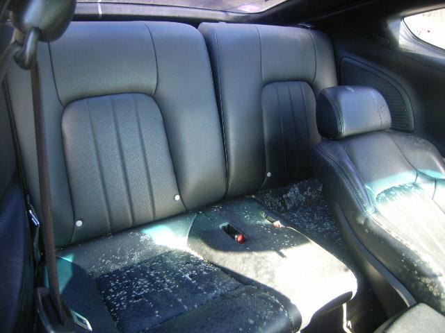

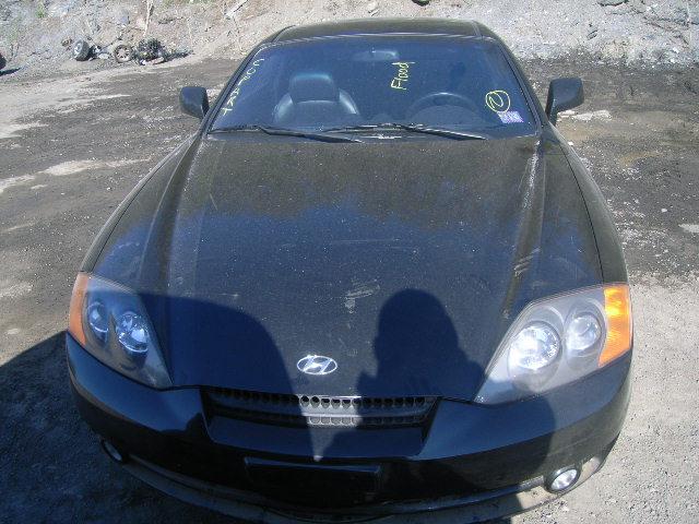

UWAGA bezwypadkowy ale po powodzi !!!!
KMHHN65F83U022986
Model Year2003
MakeHyundai
ModelTiburon
Body Type2 Door Coupe
Trim LevelGT
Engine TypeV6, 2.7L
CountryKOREA
Assy. PlantUl-san, Korea
Production Seq. Number022986
Drive Line TypeFWD
Restraint SystemDual Air Bag
Vehicle ClassSmall Car
Actual Cash Value$9,819 USD
Repair Cost$8,109 USD
Title StateCONNECTICUT
Odometer0 NOT ACTUAL
Primary DamageWATER/FLOOD
VINKMHHN65F83U022986
Body StyleCOUPE
ColorBLACK
Engine2.7L 6
DriveFront-wheel Drive
Cylinders6
FuelGAS
KeysYES
Carfax Records InfoIMPORTANT! The CARFAX database contains 10 important vehicle history records on this 2003 HYUNDAI TIBURON GT that may confirm a clean history or uncover potential problems. Order the CARFAX Vehicle History Report to see all the information reported on this vehicle.
