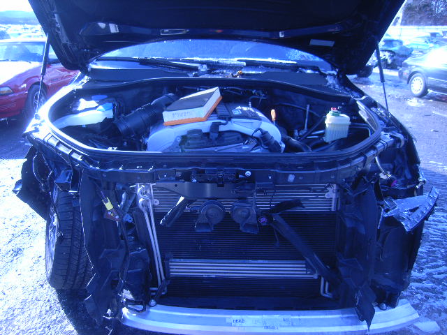

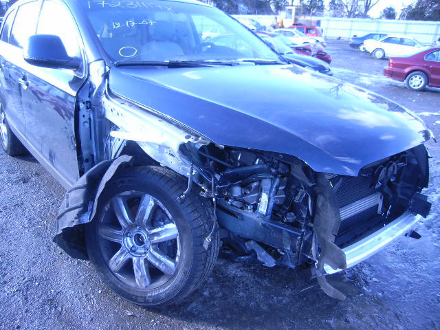

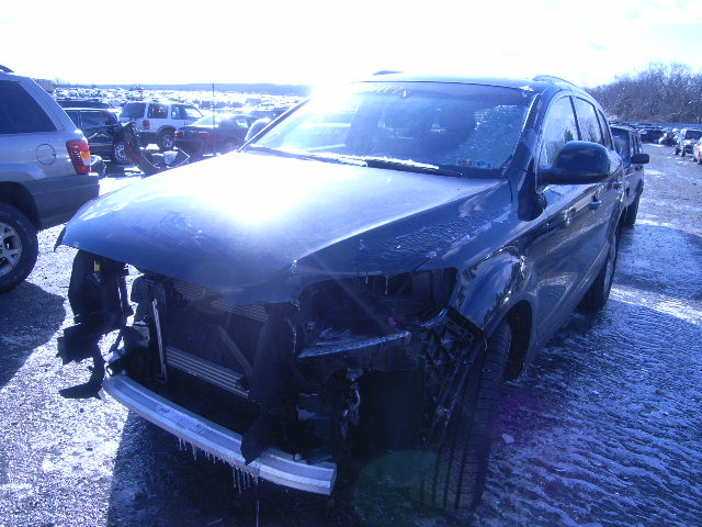

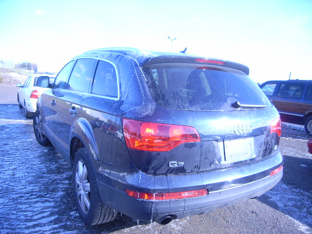

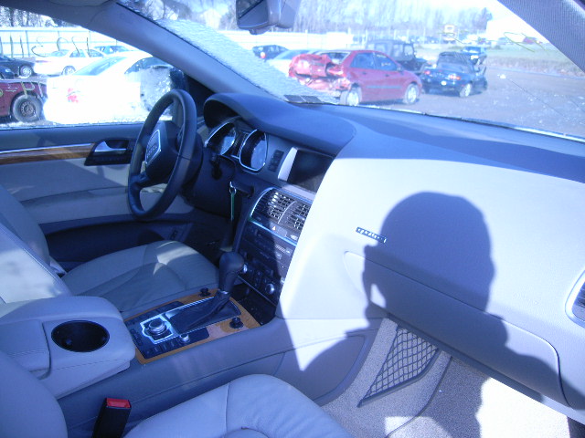

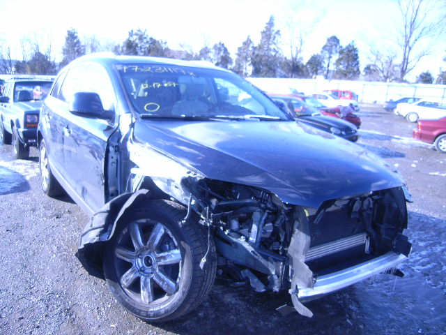

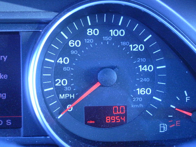

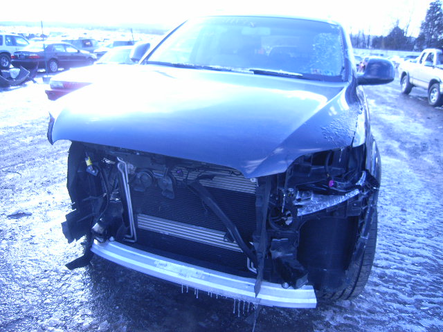

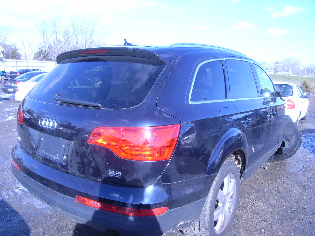

Odp: Audi Q7 3,6 2011/07/08 09:55 #14097
WA1BY74L17D092814
Model Year2007
MakeAudi
ModelQ7
Body Type4 Door Wagon
Trim Level3.6 Premium Quattro
Engine TypeV6, 3.6L
CountryGERMANY
Assy. PlantBratislava, Slovak Republic
Production Seq. Number092814
Drive Line TypeAWD
Vehicle ClassMid-size MPV
Actual Cash Value$47,912 USD
Repair Cost$0 USD
Title StatePENNSYLVANIA
Title TypeCERTIFICATE OF SALVAGE
Odometer8,954 ACTUAL
Primary DamageFront end
VINWA1BY74L17D092814
Body Style4DR SPORT UTILITY
ColorBLUE
Engine3.6L 6
DriveAll wheel drive
Cylinders6
FuelGAS
KeysYES
Carfax Records InfoIMPORTANT! The CARFAX database contains 11 important vehicle history records on this 2007 AUDI Q7 3.6 QUATTRO PREM AWD that may confirm a clean history or uncover potential problems. Order the CARFAX Vehicle History Report to see all the information reported on this vehicle.
