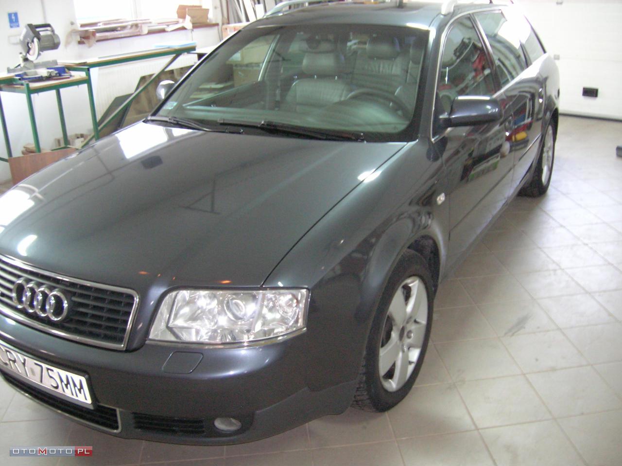

Czy mógłym prosić o sprawdzenie VIN auta:
otomoto.pl/audi-a6-2-7-biturbo-250-km-quattro-C22864730.html Nr VIN: WAUZZZ4B12N151509
Ostatnio zmieniany: 2012/02/13 20:41 przez DuZy. Powód: Poprawiony VIN - właściciel się pomylił przy podawaniu - ciekawe ...
Dekodowanie numeru VIN WAUZZZ4B12N151509 na www.automo.pl
Nazwa dekodera: Dekoder VIN dla Grupy VAG #2 Vehicle Identification No.: WAUZZZ4B12N151509 Model Designation: audi a6 av. qu. 2.7 Model: A6 Date of production: 27.06.2002 Model year: 2002 Sales type: 4B507Z Engine code: ARE Transmission code: FAX Axle drive: 5A Interior trim code: LF Roof color: F5 Exterior color/Paint Code: F5/X7Z Activated carbon canister: [1E1] : Activated carbon canister Additional child seat anchors: [3B4] : Child seat anchor forchild seat system ISOFIX Additional dust seals: [6U0] : Without additional seals outside Additional tires (winter tires): [2WA] : Without additional tires Air bag: [4UE] : Air bag for driver and front seatpassenger Anti-theft protection system: [7AH] : Electronic vehicle immobilization devicewith alarm system, passenger compartmentcontrol and backup horn Antifreeze: [1C2] : Antifreeze up to -35 degree celsiustolerance up to -40 degree C Auxiliary heating: [9M0] : Without auxiliary/parking heater Batteries: [J0L] : Battery 340 A (70 Ah) Body measures: [5C0] : Without special body measures Body style: [K8D] : Station Wagon Variant/Avant Brake type, front: [1LA] : Disc brakes, front Brake type, rear: [1KD] : Disc brakes, rear Breakaway interior mirror: [4L6] : Breakaway interior rear view mirror,automatically dimming Bumper systems: [2K6] : Reinforced bumpers CD ROM/DVD/SD card: [7QA] : Without CD/DVD for navigation CD changer/CD player: [7A2] : CD changer Carrier frequency for radio remote control: [5D1] : Carrier frequency 433.92 MHz-434.42 Mhz Cassette and CD storage unit: [4W0] : Without cassette and CD storage unit Center armrest: [6E3] : Front center armrest Center rear seat belts: [3C7] : 3-point seat belt for center rear seat Child bench seat: [3V0] : Without child bench seat Component part sets with country-specific design requirements: [B0A] : Component parts set withoutcountry-specific design requirement Components with special surface appearance: [6FB] : Body-colored exterior mirror housings Cruise control: [8T0] : Without cruise control system (CCS) Customized installation: [FC0] : Without customized installation Dashboard: [4N0] : Standard dashboard Delivery equipment: [2A4] : Delivery equipment for shipment (transitcoating) with thick seat cover Door and lid locking system: [4K4] : Radio remote controlled central locking Double-size standard radio/dual-view display: [2T0] : Without double-sized standard (DIN) Drive layout: [1X1] : Four wheel drive Emission standard: [0GE] : Emission standard EU3 Engine cooling system: [8Z5] : Not hot country Engine specifications: [MK5] : 6-cyl. gasoline engine 2.7 L/184 kW 30Vbase engine is T7Z Equipment levels: [A8S] : Standard equipment Exterior mirror setting: [6XM] : Exterior mirrors: with memory function,automatically dimming, electricallyadjustable/heated Exterior noise suppression measures: [2B5] : Additional exterior noise suppression First aid kit / warning triangle: [1T3] : First aid kit with warning triangle Front license plate bracket: [6W5] : Front license plate bracket Front underbody guard: [1SA] : Without additional front underbody guard Fuel quantity for initial filling: [1Z2] : Increase in initial standard fuelfilling Fuel systems: [0F2] : Fuel system for carburetor gasolineengine Gearshift boot/cover: [6R0] : Selector lever cover Gearshift knob/handle: [6Q2] : Leather gearshift knob/handle General operating permit, alterations: [C00] : Operating permit, initial registration Generators: [8GL] : Alternator 120 A Hand brake lever handle: [6PC] : Leather hand brake lever handle Handling standard production and pre-production series: [FA0] : Control of standard production Headlight: [8ED] : Bi-functional headlight with gasdischarge lamp, for driving on the right Headlight activation: [8K0] : Without special headlightactivation Headlight washer system: [8X1] : Headlight washer system Headlight-range adjustment: [8Q3] : Automatic headlight-range adjustmentdynamic (self-adjusting while driving) Heat accumulator system/additional heater: [7E0] : W/o heat accumulator/auxiliary heating Heating and air conditioning system: [9AK] : Climatronic with impact pressurecontrol free of cfc Identification plates: [1FF] : Special identification plate(Poland) Insert for the filling up of unleaded fuel/fuel type: [2G1] : Insert for the filling up of unleadedfuel Inserts: [5MG] : Decorative inserts, burr-walnut Installation parts for engine (engine mount system): [1VH] : Installation parts for six-cylinderengine Label for central electric: [0W1] : Label for central electricGerman-speaking countries Leather parts scope: [3HA] : Without leather parts scope Left exterior mirror: [5SL] : Left exterior mirror: aspherical Lock operation for tailgate/trunk lid: [4E0] : Tailgate/trunk lid unlockingfrom outside Lockable wheel bolts: [1PC] : Wheel bolts with anti-theft protection(unlockable) Luggage compartment floor covering: [6SJ] : Trunk floor covering, reversible mat(rubber/fabric) Luggage compartment lining: [5A5] : Trunk lining, with stowage trays Lumbar support: [7P1] : Power adjustable lumbar support in frontseats Moldings: [4ZB] : Bright moldings Multi-function display/trip computer: [9Q2] : Multi-function display/on-board computerwith check control Navigation device: [7Q0] : Without navigation device Owner's manuals: [0VT] : Information kit in Polish Paint preservative/transit coating: [5K5] : Transit coating film with additionaltransport protection measures Park distance control: [7X1] : Park distance control Partition: [3CB] : Removable net partition Quattro GmbH: [FQ0] : Standard production wheels Radios: [8UD] : Radio "concert" Rear axle: [0N6] : Rear axle with reduced tread Rear cargo area: [3GD] : Plane rear cargo area Rear fog light: [8TC] : Rear fog light for driving on the right Rear headrests: [3Q6] : Three rear headrests Rear seats: [3NZ] : Rear seat bench unsplit, backrest splitfolding Rear trim panel: [6V1] : Rear trim panel (ECE) Right exterior mirror: [5RU] : Right exterior mirror: convex(large viewing field) Roll-up sun screen for rear and side windows: [3Y3] : Roll-up sun screen for rear window andrear side windows Roof insert/convertible top: [3FE] : Electric slide/tilt sunroofwith sun screen/sunblind Roof rails/roof load rack: [3S1] : Bright roof rails Safety certificate: [0LA] : Without special plates/stickers/safety certificates Scuff plates: [7M1] : Scuff plates in door apertures withmetal inserts Seat adjustment: [3L4] : Electric seat adjustment for both frontseats, driver's seat with memory feature Seat belt check: [9P0] : Without seat belt reminder Seat covering: [N1H] : Leather seat covering Seat heater: [4A3] : Seat heater for front seatsseparately controlled Self-collection / special control: [A00] : No self-collection Shock absorption/suspension, chassis: [1BG] : Suspension/shock absorption, automaticlevel control system, air suspension atrear axle Side air bag: [4X4] : Side air bag, front and rearwith curtain air bag Side and rear windows: [4KC] : Side and rear windows in heat-insulatingglass Sill top/sill cover: [5E2] : Sill top with door cover Ski bag: [3X1] : Load-through provision with ski bag Spare wheel/breakdown set: [1G3] : Alloy spare wheel with originalequipment tires Speaker installation: [8RY] : Speakers with BOSE sound Special editions: [E0A] : No special edition Special labels/plates: [0ST] : Labels/plates in German and French Steering: [1N3] : Speed-related variable steering assist(Servotronic) Steering column systems: [2C5] : Axial and vertical adjustable steeringcolumn Steering system arrangement: [L0L] : Left-hand drive vehicle Steering wheels: [2ZQ] : Leather trimmed multi-function steeringwheel for air bag system Tachograph/logbook: [9NX] : Without electronic logbook Telepay device: [9B0] : Without telepay device Telephone/telematics: [9ZF] : Mobile phone preparation with hands-freespeaking system Tie down straps/net/pocket: [6M1] : Tie down straps Tire pressure warning light: [7K0] : Without tire pressure warning light Tires: [H3R] : Tires 215/55 R 16 93Y Trailer hitch: [1D0] : Without trailer hitch Transit coating: [NT0] : Transit coating (type 1) Transmission shafts: [1WD] : Transmission shaft for tripod joints Transmission shafts, rear axle: [1YD] : Transmission shafts for rear axlediameter 108 Transmission specifications: [G0Q] : 5-speed automatic transmission forfour-wheel drive vehicle Transmission types/gearshift mechanisms: [0G7] : Tiptronic Type approval countries/countries with special requirements: [B17] : Type approval Poland Type sign: [2Z0] : Deletion of model designation Vehicle class differentiation units/platform components: [0DS] : Vehicle class differentiation 4B0 Vehicle specifications: [F0A] : No special purpose vehicle, standardequipment Weight category front axle: [0JN] : Weight category front axleweight range 13 Weight category rear axle: [0YZ] : Without determination of weight categoryfor rear axle Wheels: [C9K] : Alloy wheels 9J x 21 front, with10J x 21 rear Windshield glass type: [4GH] : Windshield in heat-insulating glasswith sunshield Windshield wiper intermittent control: [8N4] : Windshield wiper intermittent controlwith potentiometer (four speeds) Audio-response system/voice control: [QH0] : Without voice control Child seats: [QA0] : Without child seat Danger alarm system: [VY0] : Without danger alarm system Front seats: [Q1A] : Standard front seats Hands-free system: [VX0] : Without hands-free system Remote-controlled garage door opener: [VC0] : W/o remote-controlled garage door opener TV reception/digital radio reception: [QV0] : W/o TV reception/digital radio reception Base engine: [T7Z] : 6-cylinder gasoline engine 2.7 Lunit 078.8 Instrument inserts: [U1C] : Instrument insert with km/h speedometer,clock, tachometer, trip odometer andadd. instruments (volt., oil temperat.) Tire suppliers: [V0A] : Tires w/o specification of tire brand Dekodowanie pochodzi z www.automo.pl |
Dzięki bardzo za pomoc z VIN.
Mam jeszcze pytanie - czy jest możliwość sprawdzenia historii serwisowej i wypadkowej auta? Auto było kupione w salonie w Polsce i ponoć było serwisowane w ASO. Czy da się to sprawdzić czy ewentualnie takie informacje udostępni tylko ASO? |
Oglądałem to auto i niestety jak zawsze jest jakaś wtopa.
Auto było bite ostro z tyłu - oba błotniki są w szpachli maksymalnie i nie zgrywają się dołem ze zderzakiem i dokładką. W dokładce oczywiście nie działają czujniki cofania. Dodatkowo z przodem też nie wszystko jest ok. Przednia szyba była chyba też wymieniana (jest z roku 2003 a pozostałe z 2002 - auto z lipca 2002). Szukamy dalej. |
