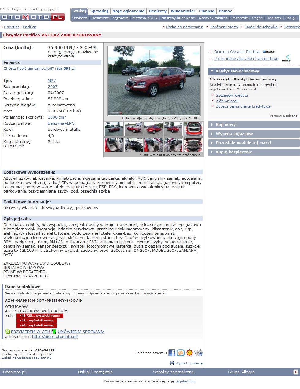

Proszę o sprawdzenie Chryslera Pacifica:
VIN: 2A4GM48456R620420 Sprawdź ten VIN na autobaza.pl ▸
Ogłoszenie: otomoto.pl/chrysler-pacifica-v6-gaz-zare...owany-C20456127.html
Pozdrawiam,
SokoleOko

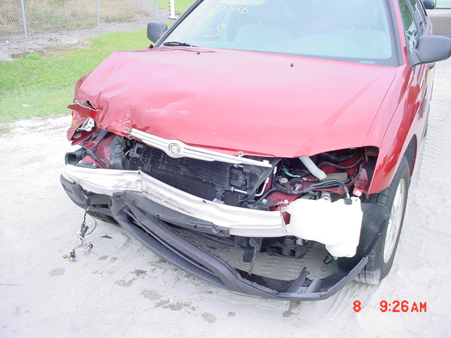

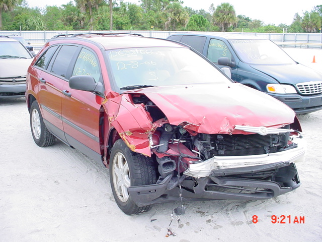

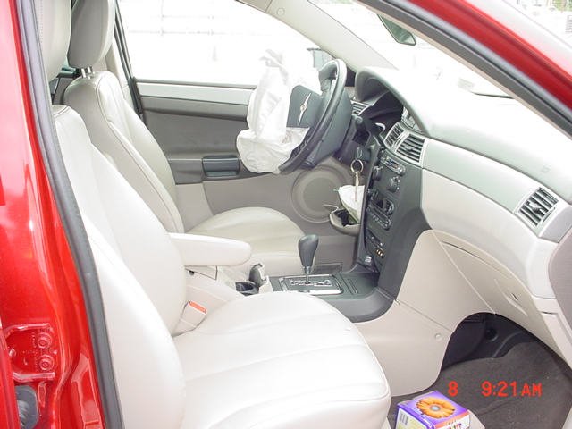

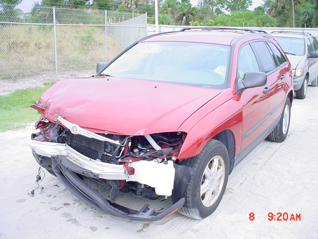

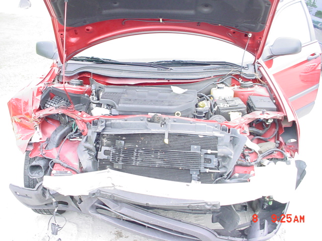

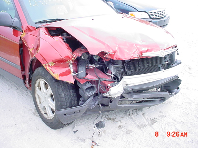

Odp: Prośba o sprawdzenie Chrysler Pacifica, 3.5L + LPG 2011/10/08 11:30 #17105
2A4GM48456R620420
Model Year2006
MakeChrysler
ModelPacifica
Body Type4 Door Wagon
Trim LevelBase
Engine TypeV6, 3.5L
CountryCANADA
Production Seq. Number620420
Drive Line TypeFWD
Vehicle ClassFull-size MPV
Brake SystemHydraulic
Horsepower250HP
Tonnage1/2
Actual Cash Value$19,240 USD
Repair Cost$15,642 USD
Title StateFLORIDA
Title TypeCERTIFICATE OF DESTRUCTION

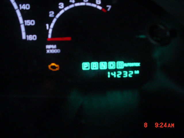

Odometer14,232 ACTUAL
Primary DamageFront end
VIN2A4GM48456R620420
Body Style4DR SPORT UTILITY
ColorRED
Engine3.5L 6
DriveFront-wheel Drive
Cylinders6
FuelGAS
KeysYES
Carfax Records InfoIMPORTANT! The CARFAX database contains 14 important vehicle history records on this 2006 CHRYSLER PACIFICA that may confirm a clean history or uncover potential problems. Order the CARFAX Vehicle History Report to see all the information reported on this vehicle.
