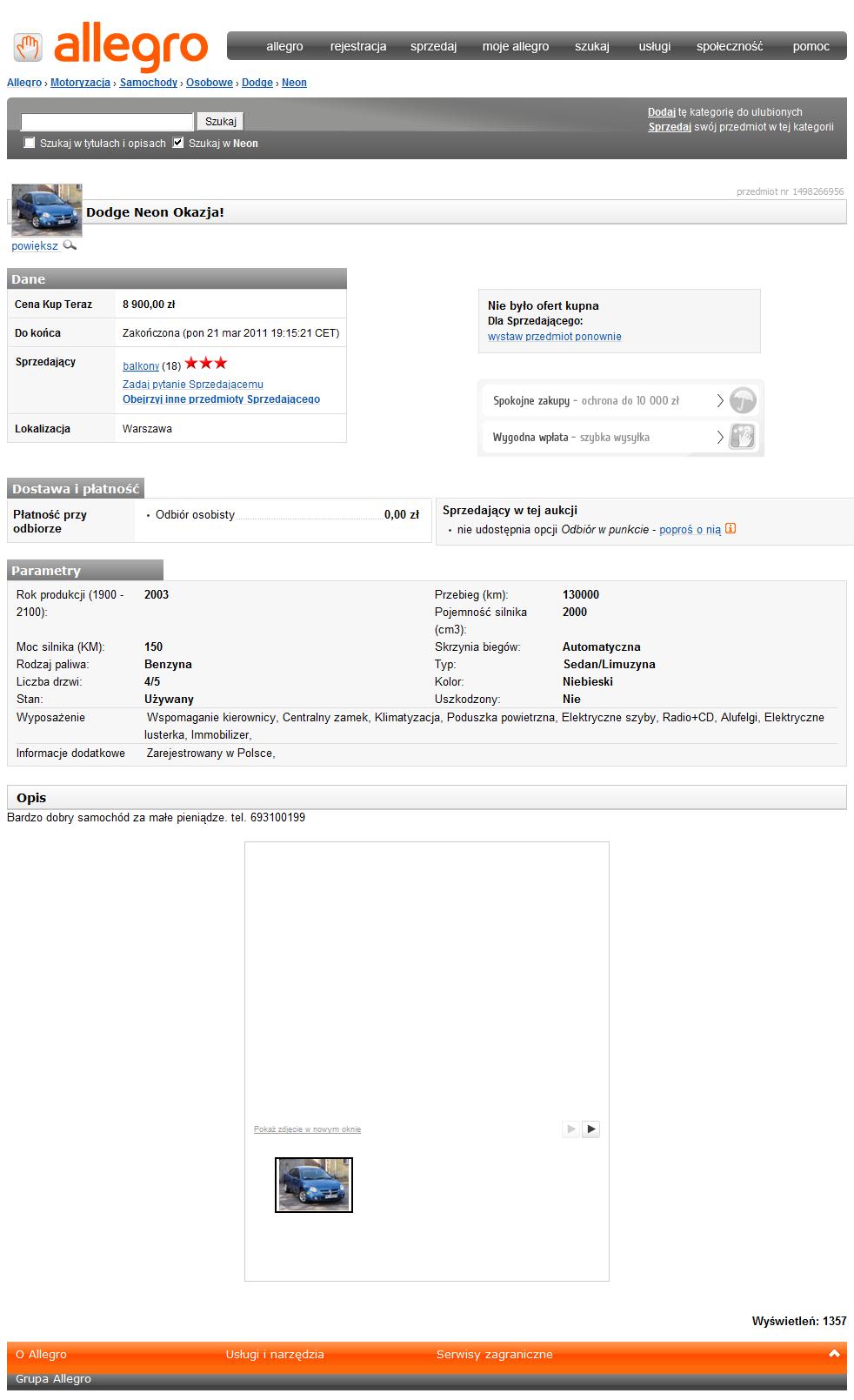

w imieniu kolegi proszę o sprawdzenie auta które chce kupić
Dodge Neon SXT '03
vin: 1B3ES56C63D257516
link do aukcji: allegro.pl/dodge-neon-okazja-i1498266956.html
z góry dzięki i pozdro

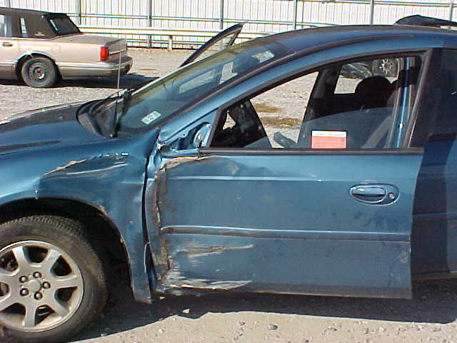

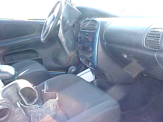

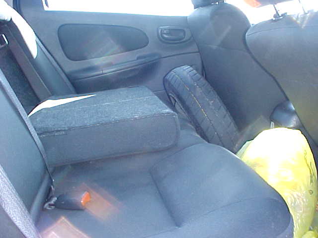

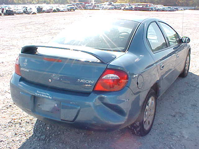

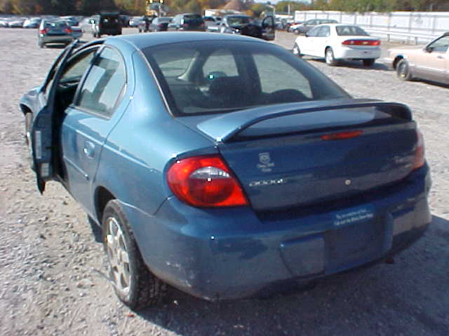

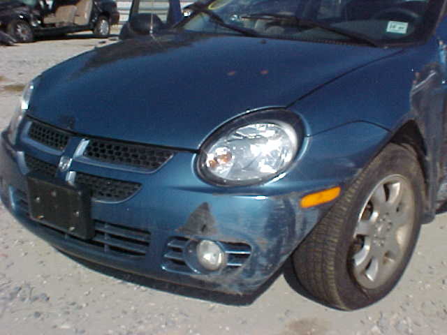

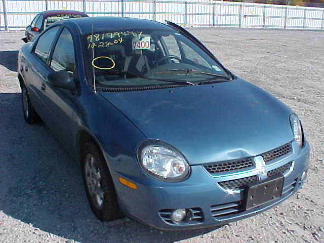

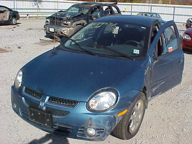

Odp: proszę o sprawdzenie auta Dodge Neon SXT 1B3ES56C63D257516 2011/03/24 19:57 #9301
1B3ES56C63D257516
Model Year2003
MakeDodge
ModelNeon
Body Type4 Door Sedan
Trim LevelSXT
Engine TypeL4, 2.0L; SOHC 16V
CountryUNITED STATES
Assy. PlantBelvidere Assembly, IL
Production Seq. Number257516
Drive Line TypeFWD
Restraint SystemDual Air Bag; Automatic Belts
Vehicle ClassSmall Car
Horsepower132HP
Actual Cash Value$8,540 USD
Repair Cost$5,982 USD
Title StateNEW JERSEY
Odometer51,352 ACTUAL
Primary DamageALL OVER
VIN1B3ES56C63D257516
Body StyleSEDAN 4DR
ColorBLUE
Engine2.0L 4
DriveFront-wheel Drive
Cylinders4
FuelGAS
KeysYES
ConditionVehicle Starts
Carfax Records InfoIMPORTANT! The CARFAX database contains 4 important vehicle history records on this 2003 DODGE NEON SXT that may confirm a clean history or uncover potential problems. Order the CARFAX Vehicle History Report to see all the information reported on this vehicle.
