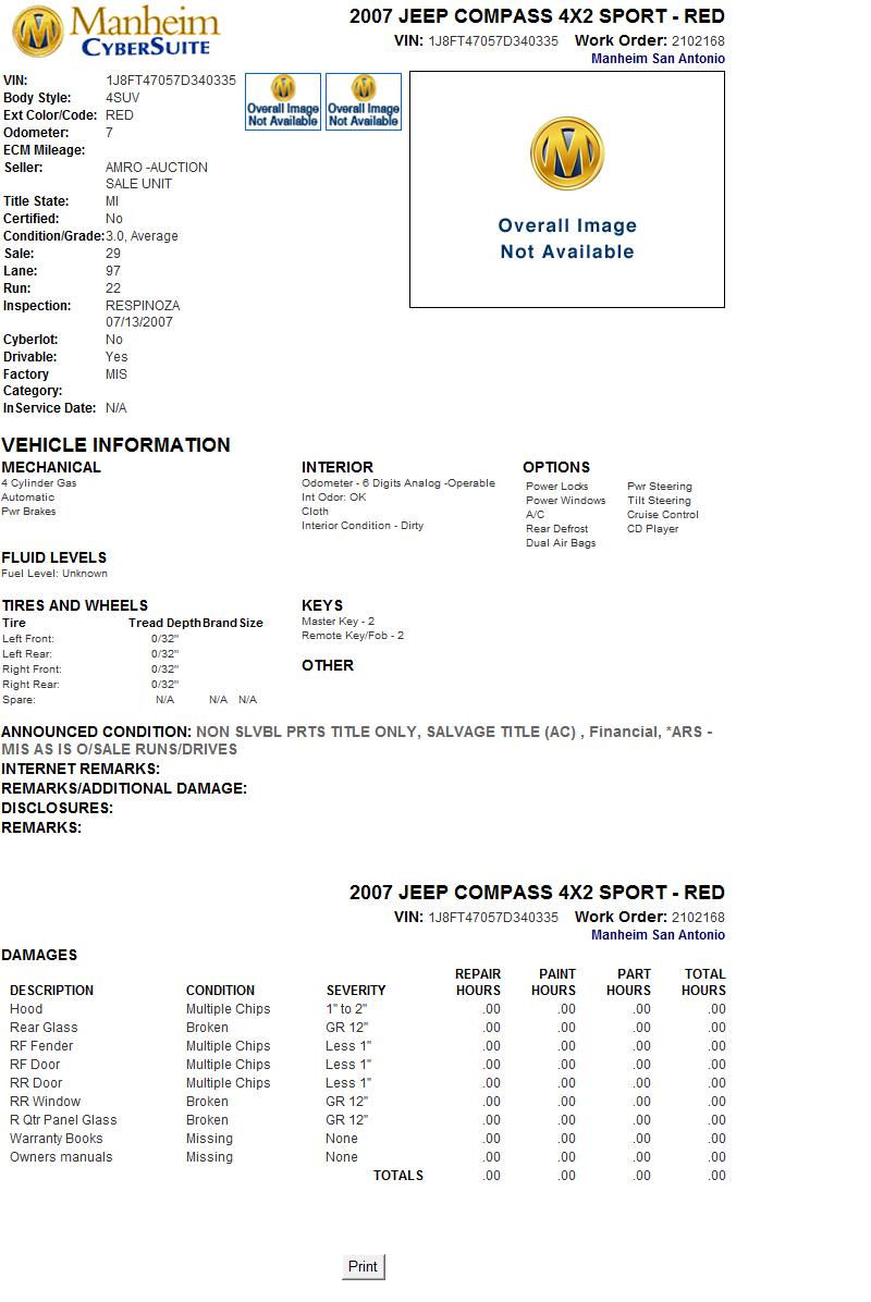

TEMAT: Proszę o sprawdzenie Jeepa VIN 1J8FT47057D340335
Proszę o sprawdzenie Jeepa VIN 1J8FT47057D340335 2011/07/05 11:14 #13982
  • Hudini
  • Hudini Avatar
Proszę o sprawdzenie Jeepa VIN 1J8FT47057D340335 , drogi ale mi się okropnie podoba.
otomoto.pl/jeep-compass-2-0i-C18379315.html
pozdrawiam
Odp: Proszę o sprawdzenie Jeepa VIN 1J8FT47057D340335 2011/07/05 12:58 #13987
1J8FT47057D340335
Model Year2007
MakeJeep
ModelCompass
Body Type4 Door Wagon
Trim LevelSport
Engine TypeL4, 2.0L
CountryUNITED STATES
Assy. PlantBelvidere Assembly, IL
Production Seq. Number340335
Drive Line TypeFWD
Vehicle ClassSmall MPV
Brake SystemHydraulic
Tonnage1/2
Carfax Records InfoIMPORTANT! The CARFAX database contains 4 important vehicle history records on this 2007 JEEP COMPASS SPORT that may confirm a clean history or uncover potential problems. Order the CARFAX Vehicle History Report to see all the information reported on this vehicle.
