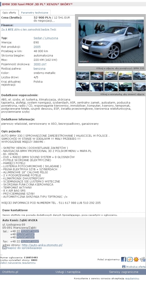

Sprzedawca może sobie mówić...
A widok jest po prostu smutny
Po pierwsze nie jest to BMW 330i tylko 325i - różnica w mocy spora.
Po drugie - Data Produkcji 2005-05-18 - NIJAK nie wychodzi 2006 rok...
VIN: WBAVB13566KX34634
Year/Make/Model: 2006 BMW 325I
Body Style: Sedan 4 DR
Engine Type: 3.0L V6 FI DOHC 24V
Manufactured In: GERMANY
Odometer Check Info
GOOD NEWS! No problem odometer records found.*
AirBag Check Info
GOOD NEWS! An Airbag Deployment has not been reported to CARFAX.
Carfax Records Info
IMPORTANT! The CARFAX database contains 6 important vehicle history records on this 2006 BMW 325I that may confirm a clean history or uncover potential problems. Order the CARFAX Vehicle History Report to see all the information reported on this vehicle.
Recall Results
BMW does not report recall information for specific vehicles to CARFAX. Please contact an authorized dealership or BMW at 1-800-334-4269 to find out if this vehicle has any recalls that require repair.
Copart Auto Auction BMW Lot Details
Lot # 691696
Actual Cash Value $37,300 USD
Repair Cost $0 USD
Title State NEVADA
Title Type SALVAGE TITLE
Odometer 0 NOT ACTUAL
Primary Damage SIDE
VIN WBAVB13566KX34634 AutoCheck
Body Style SEDAN 4DR
Color SILVER
Engine 3.0L 6
Drive Rear-wheel drive
Cylinders 6
Fuel GAS
Keys YES
Informacje o pojeździe z USA / Kanady
Klasa Upscale - Near Luxury
Silnik 3.0L I6 EFI
Kraj Pochodzenia Germany
Wiek pojazdu 5 year(s)
Ilość właścicieli 1
Rok 2006
Marka BMW
Model 3-Series 325i
Karoseria Sedan 4D
Lista możliwych problemów z pojazdem
Insurance loss title or probable total loss
Salvage title or salvage auction
Data odczytu Stan licznika
2005-08-05 99 mil = [158 km]
Lista zdarzeń
Data zdarzenia Opis zdarzenia
2005-08-05 title
2006-03-07 title salvage insurance loss
2006-04-20 vehicle exported to germany
