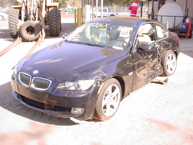

Prosze o sprawdzenie auta sprowadzonego z USA VIN jak w temacie.
Link do ogloszenia: allegro.pl/okazja-bmw-e92-coupe-idealny-pilne-i1424006582.html
Z gory dziekuje.

WBAWB33587PV70209
Model Year2007
MakeBMW
Model3 series
Body Type2 Door Coupe
Trim Level328i
Engine TypeL6, 3.0L
CountryGERMANY
Assy. PlantRegensburg
Production Seq. NumberV70209
Drive Line TypeRWD
Vehicle ClassSmall Car
Actual Cash Value$39,945 USD
Repair Cost$15,228 USD
Title StateFLORIDA
Title TypeCERT OF TITLE-SLVG&SLVG REBILD
Odometer0 NOT ACTUAL
Primary DamageALL OVER
VINWBAWB33587PV70209
Body StyleCOUPE
ColorBLACK
Engine3.0L 6
DriveRear-wheel drive
Cylinders6
FuelGAS
KeysYES
Odometer Check InfoALERT! Problem odometer records found for this 2007 BMW 328I.*
Carfax Records InfoIMPORTANT! The CARFAX database contains 7 important vehicle history records on this 2007 BMW 328I that may confirm a clean history or uncover potential problems. Order the CARFAX Vehicle History Report to see all the information reported on this vehicle.

Jak sprytnie są zrobione te zdjęcia ;:) Pilnie sprzedaje-wyjazd :D
